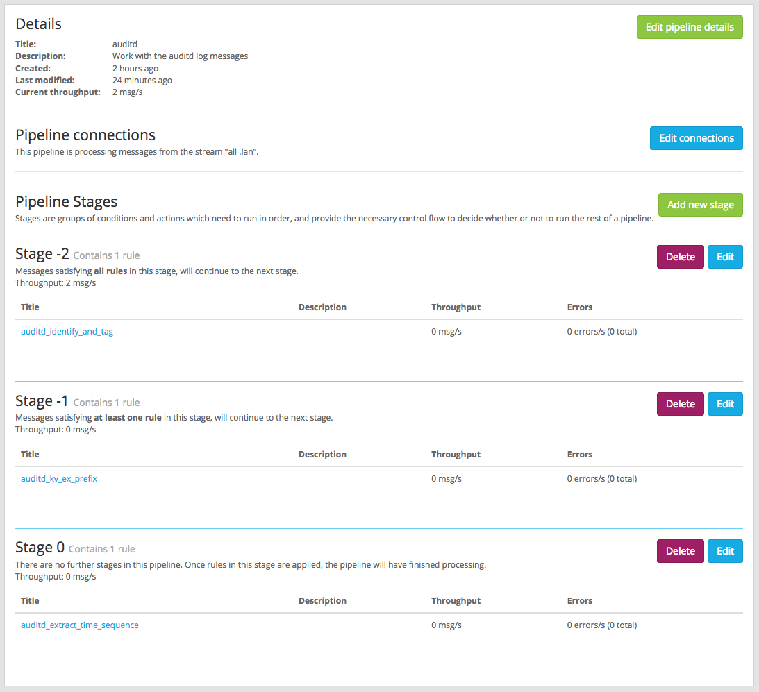

Next, create a new processing pipeline with three stages. In the first stage, place the rule auditd_identify_and_tag in the second stage auditd_kv_ex_prefix and in the third auditd_extract_time_sequence. After this pipeline is connected to a stream of messages (System >Pipelines > Manage Pipelines > Edit > Edit Connections) it will start working. It should look similar to the following picture.

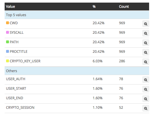

The above enables you to view all entries that belong to the same sequence (search for auditd_log_sequence: $NUMBER ) and gives you the ability to get some nice overviews (QuickValue on auditd_type) on what is going on in your system. You can also develop your very own view on what happens on your systems.
For instance, one possibly useful bit of information you might want to monitor is what ciphers are used when connecting to the system (QuickValues on auditd_cipher or search _exists_:auditd_cipher)
